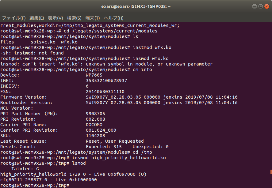

in makefile I have change “KERNEL_DIR = /opt/swi/SWI9X07Y_02.37.07.00/sysroots/armv7a-neon-poky-linux-gnueabi/usr/src/kernel/” to “KERNEL_DIR = /opt/swi/SWI9X07Y_02.28.03.05/sysroots/armv7a-neon-poky-linux-gnueabi/usr/src/kernel/” and i got this
root@swi-mdm9x28-wp:/legato/systems/current/modules# insmod wfx.ko
[ 9379.582496] wfx: version magic '3.18.131 preempt mod_unload ARMv7 p2v8 ’ should be '3.18.140 ’
[ 9379.627617] wfx: version magic '3.18.131 preempt mod_unload ARMv7 p2v8 ’ should be '3.18.140 ’
insmod: can’t insert ‘wfx.ko’: invalid module format

i have changed fw and toolchain ;
root@swi-mdm9x28-wp:/mnt/legato/system/modules# fwupdate query
Connecting to service …
Firmware Version: SWI9X07Y_02.37.03.00 73df45 jenkins 2020/04/08 10:59:14
Bootloader Version: SWI9X07Y_02.37.03.00 73df45 jenkins 2020/04/08 10:59:14
Linux Version: 3.18.140 #1 PREEMPT Wed Dec 9 08:50:05 UTC 2020
root@swi-mdm9x28-wp:/mnt/legato/system/modules# legato version
19.11.3-1-g8c030edad_1cb5588a1616da9539229ce885e23405
root@swi-mdm9x28-wp:/mnt/legato/system/modules# insmod wfx.ko
insmod: can’t insert ‘wfx.ko’: unknown symbol in module, or unknown parameter
root@swi-mdm9x28-wp:/mnt/legato/system/modules# modprobe wfx
modprobe: module wfx not found in modules.dep
it still has same error as before ,i don’t know which line that makes the problem of “unknown symbol in module”
